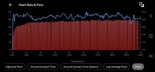

    Battery is good, HR during workout ok, but  after stop workout, the HR is stuck at very high HR, although my HR max during the workout is 165 only. But after saved the workout, the HR shown in the watch is 224 bpm, it is crazy, because my Max HR is about 186-188 only.
    I had to disconnect the HRM pro from the watch, then my HR is back to Normal (90bpm, after workout 3 minutues).

  • You show a picture of the HR on a third-party CIQ watchface
    . It may be a faulty code in the third-party app.
    Please compare the HR with the original Garmin HR widget.
    If the Garmin HR widget is correct and the third party watchface is incorrect, you should contact the developer of the watchface.
  • Not sure. But after disconnect the HRM pro, my HR back to normal. And never have this issues before.
    But I will test one more time with default watch face with Recovery HR after workout to make sure.
  • Now I can sure it is not because of watch face. See the HR report in garmin connect
    It is unbelievable. After finish workout, although I run close to LTHR, max value of HR during thr work out just 165, but when stop workout, the HR nearlly 200??? Although I feel really good and stop the workout 1-2 minutes?
