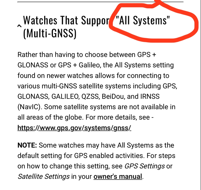

The Fenix/Tactix 7 uses the AIROHA AG3335M(N) GNSS chip which can receive GPS, GLONASS, Galileo, BeiDou, NavIC and QZSS. And this website says the Fenix/Tactix 7 supports all of those constellations: https://support.garmin.com/en-SG/?faq=13CvcPK8Um0mekc3F2eVmA

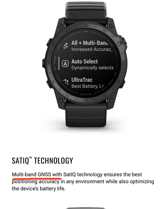

However, the Tactix 7 product page lists only GPS, GLONASS and Galileo, and NavIC support was only added in the 15.74 firmware. This implies that the firmware has to support a constellation before the watch can use it for navigation, even though the hardware can already support it.
