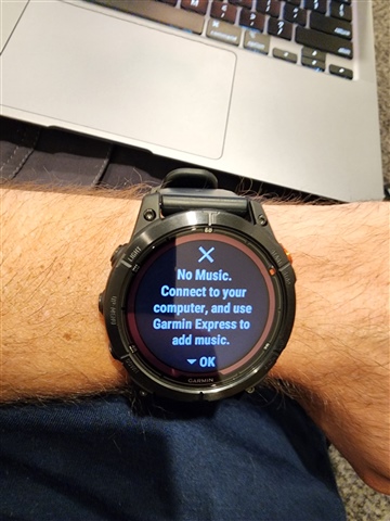

I upgraded from a Fenix 6X Pro to a Fenix 7 Pro Solar (no wifi).
I am no longer able to control music playing on my phone.
When I open the music control widget, I can see the Play, Skip, and three dots for the additional menu.
If I click Play, I am prompted to connect headphones. When I skip that, I get the message "No Music. Connect to your computer, and use Garmin Express to add music."
Under the three dot options, I have no other option other than "Phone", not "Control Phone" like I've seen elsewhere on the forum.
I am running the latest software on the watch, and the latest Garmin Connect app. All phone permissions are also enabled. I understand I can't download Spotify or other music app due to the no wifi model, but does that also limit the ability to control music on my phone?
Is there another option that I may be missing or is this a software bug?

  • I tried to go through the settings as in the video but my options are different.
    When I go though the menu and click music, I have no option for "music provider", the only sub-menus I can see are "Headphones" and "Audio"
