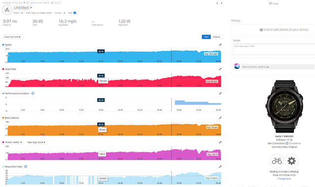

    I also use the Polar H10 with my tactix 7 (and other watches).  I had seen some flaky results with the H10 when I had both the ANT+ and BlueTooth connection options available on my watch.  After I completely removed the BT connection option in the Sensors menu, and only used the ANT+ connection option, my HR recording with the H10 has been rock solid (several months).
    You might want to check that you are using only the ANT+ connection option for the H10, and that the Bluetooth connection option is not just turned OFF, but removed.
    For reference, here's a recovery ride I just finished showing solid HR recording:
    HTH
