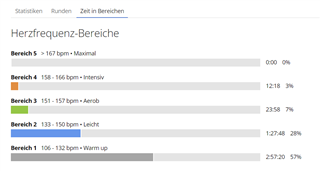

it seams, that my Fenix 7x pro calculates the intensity minuts wrongly:
In my today's hike it recorded:
The setting is on "use HR zones" and selected are zones 3 & 4.
If I look at the "time in zones" graph of the activity I get:
So should be ~24min normal + 12min high => total of 48 min, not 29 as shown.
Any idea on what is going wrong here?

    Hard to tell without seeing the detailed activity data, but there can be a significant difference between IM and Zone times, even when you use a device not requiring the 10 minutes interval. That's because the current minute won't be accounted as an IM if it is not completed. It means if you stay 55 seconds in Z3, then the HR drops back to Z2, the IMs won't be incremented (while HR zones will). When the HR rises back to Z3 later again, the counter starts from 0 seconds. In other words, although the 10 minutes continuous requirement is no more used at recent models (which I actually find wrong), you still have to sustain at least 60 continuous second in the concerned HR zone. In other words, the requirement of 10 continuous minutes over the threshold was in fact just replaced with 1 minute, not really removed entirely, although it may look so, when reading  the documentation.
    So, IMs indeed are what their name suggests - Intensity Minutes, it means the sum of all minutes spent in the intensive zone, not the total time spent in the intensive zone converted to minutes!
  • Thank you for the hint, but the Fenix 7x Pro is listed there with the "devices that do not require a 10 minnute threshold". So that should not be the reason.
    Yeah, my bad. So analyze the HR graph and manually count the full minutes above the threshold you set, as has already suggested. Simply adding up the total times of the HR zones isn't the correct way.
