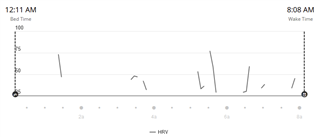

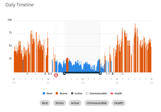

I have a Fenix 7S Pro SS and having issues lately with the measurements: it depends of the day, but always min gaps or lot of.
Yesterday:
the day before
in the watch itself there are no gaps, but because I think the way the format of the graph is in the fenix 7s pro ss, since it just continuous the line where the gaps are.
Does anyone know how to fix it? I don't have any gaps in HR measurements during the day or night.

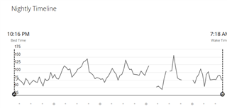

  • I don't see gaps in the graph on the watch but I think this is due to to the way it charts it, just connecting each data point, even if there are only a few throughout the night like you mentioned before.
    My charts are even more sparse than yours and more closely match the ones posted above by @6634965.

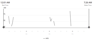

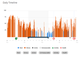

    Here is last night's HRV graph:
    And the night before:
    And this is May 4th and how almost all of them looked prior to that date:

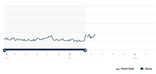

    I have no battery saver settings enabled, and like you, my heart rate graphs through the night are solid:

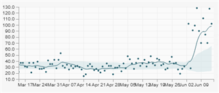

    Just to demonstrate my own issue with this:
    The HRV spike that has occurred since June 2 is directly correlated with the overnight HRV gaps, and gaps in stress measurement.
    First thought with this was that there had been some sort of physiological change with me (a heart rhythm change for example), but I work in an environment where I have access to the tools (proper EKG, I teach electrophysiology) and can confirm that my physiologic state hasn't changed.
    There is something here, either hardware of software (software seems much more likely with more than one person and device involved).
