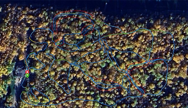

    I have a network of trails I built over the years, many of them interconnected.
    I am just curious what the combined distance is of all the trails.
    It's impossible to walk them all without walking over some sections twice, so when I am using walking activity to measure, I am not getting an accurate distance.
    I guess I could walk each segment, save it, start a new activity, walk another segment, save, repeat, until all are covered then add them all up manually, but I was hoping there'd be a way to record waypoints and add the distance between all the waypoints without duplicating any segments.
    Uploading to google earth would be cool too so I could see where they all are, I can do this with a walk where I have backtracked/walked twice  over some segments but some of those show as double lines. I think with waypoints I can average them to get them more accurate. As you can see with the attached screenshot where I walked them all, there's a few places (outlined in red) where I walked the same path twice that show up as two separate lines when they should be one.
