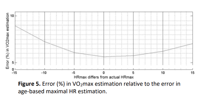

    Getting your Max HR as accurate as possible for running is important as the error in VO2 Max estimates increases with errors in Max HR.
    https://assets.firstbeat.com/firstbeat/uploads/2017/06/white_paper_VO2max_30.6.2017.pdf
