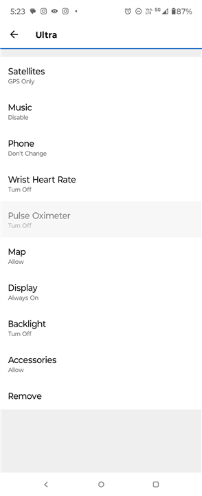

  • What I use with my Enduro 2
    1) set map to North up not track up
    2) use GPS only, it's good enough for ultras
    3) use power profiles to set backlight to off. Then I can only switch it on with the light key
    4) in the activity settings switch the touch screen to off
    I've never had it go into sleep during an activity, had you paused it to resume later or something?

  •  My ultra power profile settings

    This is exactly what I use during my ultras. I've also never had sleep activate due to the movement / heart rate during races, but that's absolutely *** that yours has done it.
    I have a base model Fenix 7 and I use around 2-3% during races. It easily makes 24 hours.
    An important note is to not leave the map screen running when not actively navigating. It's by far and away the biggest drain.
