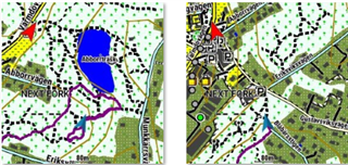

    For a month now I've been working on my map style. The focus has been to have a map that's working great for hiking and trail running with lines and poi's that are visible even if you are above 40 and with inspiration from orienteering maps with for instance, the possibility to differentiate different paths and tracks more. Another thing is that I've tried to get rid of most of the text that's cluttering the map when it's zoomed out. (I have an epix pro51 and maybe the thickness of lines and objects are different on other models).

    I've set up 8 levels and mapped them to resolutions in the options file
    "levels = 0:24, 1:23, 2:22, 3:21, 4:20, 5:19, 6:18, 7:17".
    After a lot of trial and error, I've got the below table as a standard. Detail here is the setting in the watch in the menu Map-> Detail or it could also be configured in activity specific menu.
    With detail=normal I can control visibility from scale=120m, detail=less it's controlled from 80m and above and detail=high from 500m.
    As you also found out all poi's with code starting with 0x02yy behave strangely and most of them just show up to 80m regardless of style config. That can be used if you want that effect. For instance, if you have an object that you only want to be visible up to 80m, even if you are using detail=normal. I've moved many of the standard 0x02 to other codes in my style.
    Some examples from my style:

    Some symbols have the name show up as default and others not. I've not found a way to effectively hide/show. The only thing I can control is to hide the name, by deleting it. Then it's not showing up, but it's also not viewable when tapping the object on the map. Does anyone know of a way to show/hide without altering it?
    One other thing to keep in mind is the area/object priority in typ file. A couple of times that has given me strange behaviors when zooming in and out.
