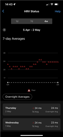

However, Garmin seems to not accept my differentiation in that area. It has never set my baseline and keeps marking it as "poor", basically telling me that I am never fully recovered, flashing those red alerts at me every day.

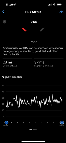

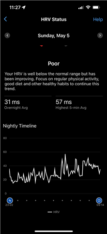

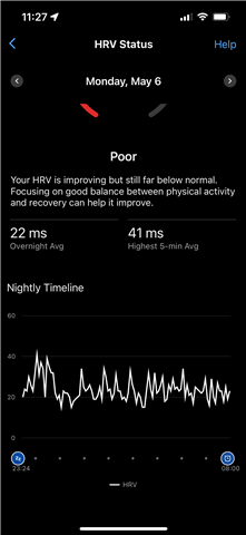

    This is what I see on my watch (since February):

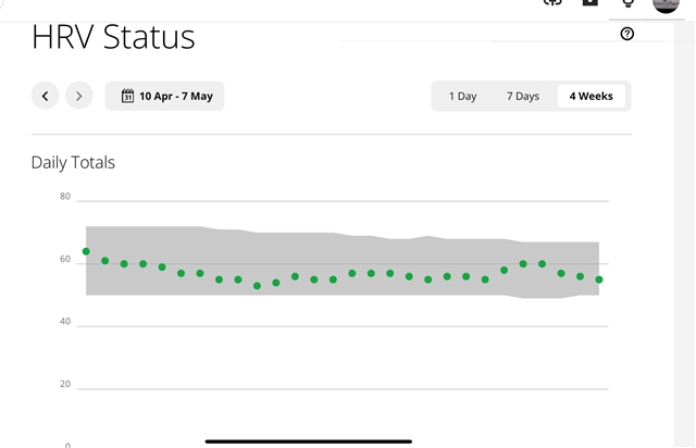

  •  What do you mean by threshold? The grey area visible on your screenshots? This is baseline. And that is exactly the issue described in my initial post - the fact that Garmin decided that I can't have one.

  • Baseline - a line serving as a starting point, the thresholds show a range between which data can vary. Like having low HRV defined as poor by one company or good by another, it’s a label.

  • For the record. Without any improvement on my HRV values, Garmin has finally established a baseline for me (21-28) and stopped displaying "Poor HRV" notices. So both Garmin docs & email support were wrong about that. It took the app almost 3 months (11 weeks) to establish a HRV baseline for me.
    Thanks everyone for the advice. If I could somehow summarize it: it's always good to aim for the higher value (compared to your history) but there is no actual scientific evidence that low baseline is any indicator of compromised health. In my opinion Garmin should stop comparing HRV to age averages at all, as this approach seems to be wrong and misleading.
