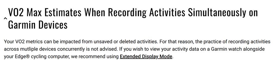

  • Bearing in mind that, for the sake of data accuracy, Gamin advises against dual recording.
    Using the Extended Display Mode allows you to view, in real time, most of the available Fenix activity data  on your Edge head unit. Alternatively just record the activity on your Edge unit and sync with the Fenix. One caveat if that some users are losing their active calories from their rides when synching with EDGE x40 devices.
  • thanks mcbit!       but what does extended display mode mean? does just uses the fenix data? and no dual recorind problem?
  • You will see the data captured by your watch.
    This is a very limited view that most will use during a Triathlon. You can record with your watch and will see (some) data on the EDGE.
    If you don't do triathlon record your bike trainings only on the EDGE. Everything will synch back after you saved your workout to your watch.
