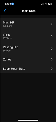

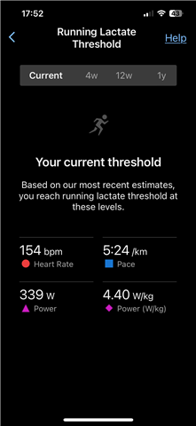

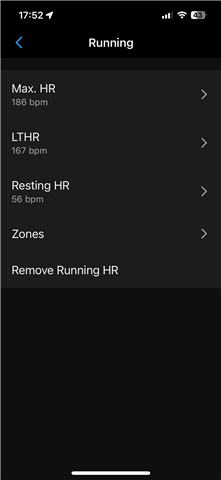

    Yes, and GCM still confuses it after so many years. Garmin quite patheticly thought that if they were  renaming “Lactate threshold” to “Running Lactate Threshold” it would solve this confusion. Nope.
    Eg. today my Edge 530 detected both a new FTP and a new cycling LTHR (154 bpm). GCM put it into “Running Lactate Threshold” next to running LT power and LT pace replacing my former running LTHR of 167 bpm. As it has been the case for more than 5 years,  maybe already 10 years, just for a long time w/o running LT power, because the latter was added  later.
  • It is why also  running LTHR chart has jumping up and down, and not because I can increase or decrease my LTHR by 10 bpm or so.

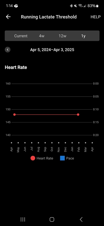

  • I wish mine would change. Hundreds of high effort and intensity activities in this span of time
  • How close do you think that is to your max? Doesn't look like it's been detecting a threshold at all, after they released the software version that made it auto.
