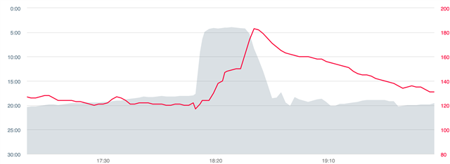

  • I have noticed this as well.
    Before update and a good run after the update:

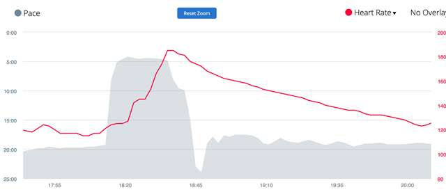

    Bad data found after update:
    The recorded heart rate jumps after I stop the sprint. It makes it much harder for the watch to recognize anaerobic exercise.
    The reason I got the HRM Pro originally was because of how poorly the optical heart rate works on me with my thin wrists. This update seems to be leaking inaccurate data from the optical heart rate sensor into the data from the chest sensor.
    What we really need is an indicator for which sensor it's using, an explicit alert for unreliable data from the chest HRM, and an easier option to disable the optical HR sensor.
  • So you are saying that the last example is from an external sensor? That is horrible!
