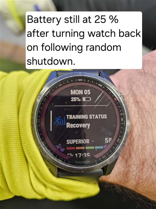

I have a Fenix 7S Sapphire Solar. During outdoor GPS tracked runs the watch is randomly shutting off, with increasing frequency.
It first happened during the New York Marathon in November, and the frequency has increased since then. I have read about a similar issue with other models of Garmin randomly restarting, but in my case, it is just turning off. I can turn the watch back on just by holding the power button. The battery percentage after I turn the watch back on is anywhere from 20% to as high as 38%.
On some occasions, after turning the watch back on, it gives me the option to resume the activity, but other times, it goes to the watch face, and the activity to that point is lost or corrupted (as was at the NYCM). If I am able to resume the activity, the watch will turn itself back off within a short period of time (5 or so minutes). If I don't resume the activity, the watch will function normally in non-activity mode for many hours, depending on how much battery is left when I turn it back on.
Based on the responses to other posts where the watch is restarting on its own, I have tried both a soft and hard reset, but that issue still occurs.
The battery seems to be holding a charge properly. I don't see any signs of excess drainage. As I said, sometimes, when I turn the watch back on, the battery percentage is in the mid-30s. The lowest the battery has even been when I turn it back on is 23%. At the NYCM, when the watch turned off as I was saving the activity following the race, the battery was still at 27%, but the activity data was completely corrupted. It seems to be somewhat related to the battery because it has never occurred if the battery doesn't go below 40% during the activity.

  • I somehow happened on what likely is the cause of your issue.
    In short, The OS has thresholds where itll auto shut off. I dont recall exact numbers, but say its when 10min are left only.
    Well while you are using your watch during an activity, at say 30% with a battery life remaining of like 5 hours with a currently in progress activity.
    If at some point during this activity "something" happens to bump up the battery consumption, like you activating the flashlight, or some obscured system sub-process, even if that actually was only going to run for seconds consuming little battery, the OSes watch dog basically saw "BATTERY DURATION REMAINING HAS DROPPED BELOW MINIMUM THRESHOLD. TRIGGERING RESPONSE".
    From other forum posts, it seems garmin has acknowledged this and going to implement a fix. This same issue triggers your "battery saving" watch face mode on your watch and ends your activity, if you had that feature enabled in some cases as well.
  • Certainly seems possible, but it's happening many different battery levels. Sometimes as low as 23% and as high as 37%. If it was always when the battery reached 30% or 35% that would be more likely. But since sometimes it gets down much lower, the threshold would seem to be changing.
    I do hope Garmin come out with a fix, but I can't have this happening in the middle of a big race or long training run.
    Thanks for the reply. I'll see if maybe Garmin have any suggestions until the fix is released.
  • I feel bad that i cant find the threads to link to you. But your response was echoed by others, which then were followed up with people explaining the cause that made sense to me. Maybe searching some of the terms/concepts in our convo here may lead to them? If I recall it was both here on garmins forum and on reddit I saw these discussions.
    I think even in your case with 23% and 37% its got to do with things like, for certain actions can "drain" 20% per hour, but those "actions" run once every 3 hours, for a period of .01ms or something. Since the OS is closed source, we can only observe the behaviors of the system and formulate off of that.  From a batteries perspective 23 and 37 percent arent that far apart voltage wise since your battery doesnt drain to 0v, and those high power consumption nanosecond actions could knock down that voltage for enough time for the watch dog to observe the "critical" battery level.

  • I think even in your case with 23% and 37% its got to do with things like, for certain actions can "drain" 20% per hour, but those "actions" run once every 3 hours, for a period of .01ms or something. Since the OS is closed source, we can only observe the behaviors of the system and formulate off of that
    I'm sorry but, with all due respect, this is pure speculation with little, if anything, to back it up.  For that matter I have seen nothing to indicate this is a commonly found issue. I can imagine what the forum would look like the day after a major marathon - nothing but "my watch rebooted during my race".!  I can't count the number of times I have been out well over 3 hrs and ended with a battery level of 10% or less.  G514 - call support.  Who knows, maybe I'm wrong and they will acknowledge the issue.
  • I plan to call them as soon as I get back to my hotel, or if they're closed by then, first thing in the morning.
    As you said it can't hurt. f they can offer any solution that's better than buying a new waych it will be progress. It's not like I have $1300 sitting around. And to make matters worse it would be for the exact same model since they haven't released a Fenix 8. A top end watch should last at least 2 years until they release a newer model, or longer.
  • Did you... find the threads I was trying to find to give you confidence in your very convicted position? I suppose I just want to understand why you are so confident this CANNOT be possible.
    Battery watchdogs do have wacky behaviors like this. Have you had any exp with embedded systems or similar platforms?
