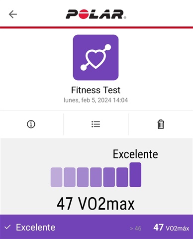

I have the Fenix 7s Pro and the vo7max that is showing is 40 but If I do the test with Polar H10 and Polar Flow, it says 47... something is wrong with this watch. (lastest version of the software)

Even if the vo2max is an estimate, you can quite deduce which one is more accurate just looking at your age and performance. 40 is very low: how old are you, and what's your times on 1km, 5km and 10km?
40 is very low
It depends - and since the screenshot indicates his/her VO₂max is in the middle green field ("Good"), it does not seem to be that low for his/her age.
.. besides that, a number of runs needs to be done, before a more accurate VO₂value is established. Preferably with a HRM chest belt.
Yeah, I was thinking 40 as 'very low' compared to the 47 of the other one, not in general. That's why I was asking for age and some pb times on runs: the discrepancy of 7 points with the polar it's a lot, even if the Garmin is using only the optical sensor vs the H10.
The model used by Garmin to estimate VO2 Max is accurate, even from sub-maximal efforts. The average error is 5% (which is still about 2 points of VO2 Max). Keep in mind, this is the average error. For some people it will be higher, to some people, of course, if will be lower.

I didn´t do the run test, I will try this again
I believe the Polar H10 is better, I have 52 years old
I don´t run, I practice cross training and walking in zone 2
