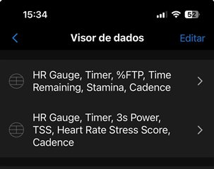

  • Hi,
    Even after I checked pages configs on GCM and on the watch I still get blank charts from a Connect IQ app that is not present on any page for this specific profile/activity.
    I changed the layout to 8 fields in order to find any “hidden” field and then back to my usual 6 fields pages.
    alphaHRV app charts should not appear on Garmin Connect for this specific activity once it is not configured on any data page.
