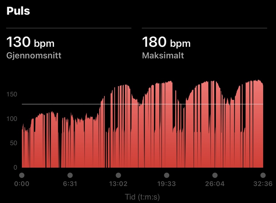

When i run on treadmill my heart rate falls out. Its only on treadmill. I have tried on two different treadmills, I have tried two different belts as well. Ant tips?
Try tightening the watch up on your wrist a notch or two and see if that helps.
Are you use HR sensor build-in or external?
Do you have HR transmitting option ON?
Do you have auto sensor discovery enabled?
Garmin heart rate belt.
hr transmitting off
auto sensor is on.
Indoors can be quite "noisy" from an EM perspective, with interference from microwaves, wireless routers, etc, and you can get droputs from HR belts.
If you are getting interference using the default ANT+ connection, try deleting the belt in the sensor menu, and pairing it again using Bluetooth.
I would say, set auto sensor to OFF, maybe you watch is discovering something and it causing such dropouts.
I mostly do my runs outside but had some activities on treadmill in the past and never had such issues..
Fenix 7 with HRM-Pro belt.
This is the correct answer
