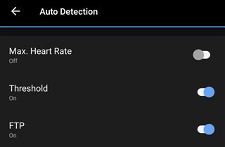

My configuration (it has not changed from last 6 months):
  (Screenshot from Fenix)

  • My max heart rate has not changed, I have disabled max HR detection.
    I have doble check and it still is correctly set at 184bpm, max HR from race, no changes in this year.
    I use HRM run band too that I forgot to mention it.
    Thanks for answer anyways, it could have been a possible solution.

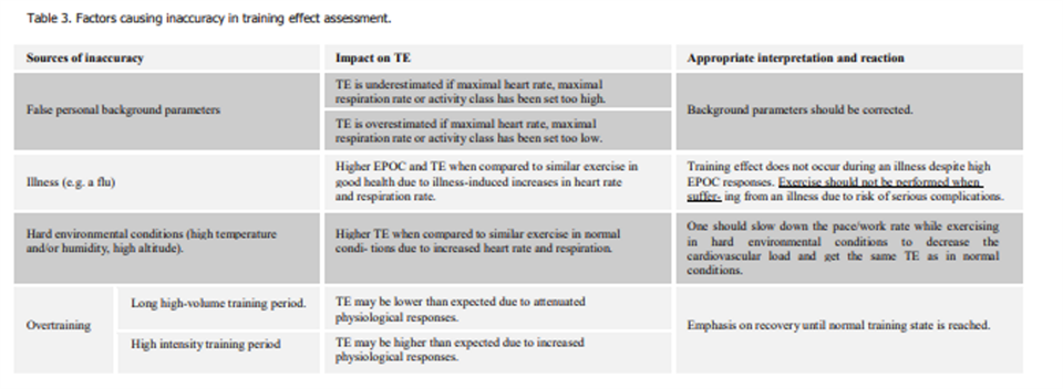

    According to Firstbeat white papers, there could be several reasons why the TE might be off:
    If you have been training for your 10k, you could be in the "overtraining" response.
    Anyway, there is nothing that indicates there is a software issue with your watch.
