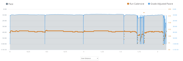

  • So, I walked three times around the block (and then to the supermarket and back home). The first half of the round had overall a good gps signal, the second half less so. Tried to keep my walking the same at every round and followed the same markers on the sidewalk. First round: without pod, second with pot and calibration factor 1.05, third with 1.1 The gained distance and pace looks half realistic, as in first round 470m, after second 990m, after third 1540m. At least I now know the thingy is working. Now I need to consider how to use it. Smiley
  • So, after some testing of the footpod: setting it to pace doesn't work for some reason. Then I sometimes get the interesting pace plot where my pace is slower than walking when running and fast running pace when walking. Or basically a similar pattern when doing intervals. But setting it to distance always on seems to work.
