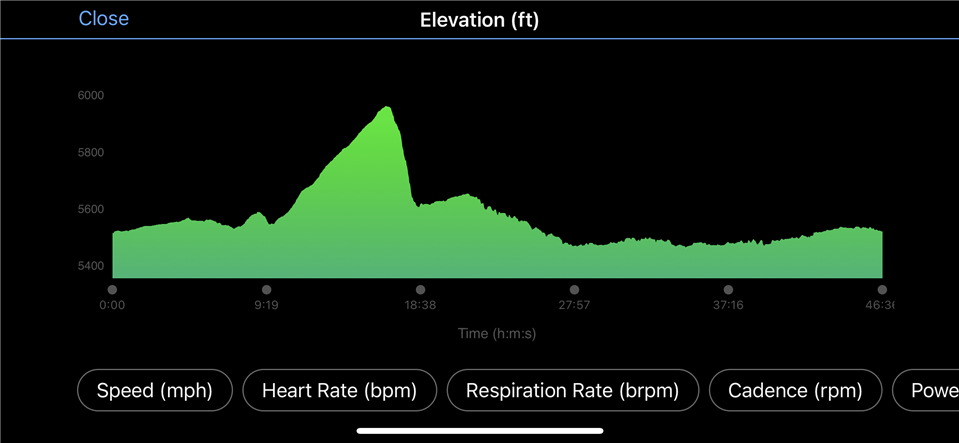

I’ve had the Fenix 7s sapphire solar for about a month and the total ascent calculation for my activities is almost always wrong compared to Strava’s calculation and my old vivoactive 4s altimeter readings for known routes. I finally noticed that although the fenix 7 graphs follow the same basic pattern, it has very small “choppiness” which is causing it to calculate more ascent than is accurate. The attached screenshots are of of a known route that has about 600 ft of climbing. Top is the vivoactive 4s and bottom is fenix 7s. The vivoactive 4s is accurate at about 600 ft. The fenix 7 consistently records about 800 ft of climbing. This has affected all my rides by about the same percentage. Has anyone else experienced this or know how to fix it? I have tried restarting the watch and multiple calibrations of the altimeter. Any help is appreciated.
  • Edit: The top screenshot if from the Fenix 7s. The bottom is the vivoactive 4. You can see fenix 7 is noticeably choppy.

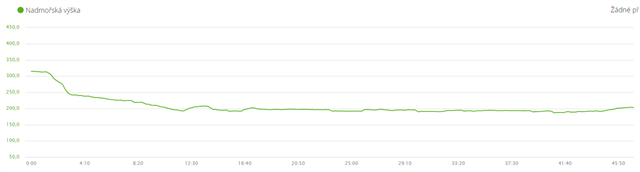

    These are two graphs, same route (home to work) most by the river.
    Wrong total ascent
    Correct total ascent
  • Sorry, absolutely can't agree. For 6 years with F3 amd 9 month I haven't had any problem, than every activity (two F7X) with wrong total ascent. Difference depending on how fast and which elevation profile was just if I have 1/3 ar almost double more meters uphill, always more than reality.
