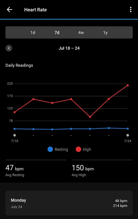

  • Apparently it also reads it wrong without my HRM. This run today, I forgot the strap but it skewed my HR again, claiming a max of 214bpm!
    In your place, not because I would take too seriously, but just to be sure, I would do a lab test with ECG under load to check whether you do not suffer from arrhythmia. Personally, I do not have any false Max HR detection issues, regardless whether I use the wrist HRM or my HRM-Pro, but everybody is different, and your HR curve may be simply different (while still healthy) and can lead to the false detection. Only a specialist will tell you.
  • I understand what you are saying and I think that makes sense. However, my point is moreover that whenever Garmin reports a maxHR of 214 in once place, I would expect it to show in the run as maxHR as well. They should both reflect the high value or both don't, right?
  • However, my point is moreover that whenever Garmin reports a maxHR of 214 in once place, I would expect it to show in the run as maxHR as well. They should both reflect the high value or both don't, right?
    Perhaps it was not detected during the run.

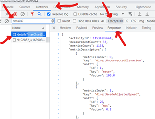

  • It would indeed be helpful to be able to find out when during this day I had 214bpm. Would this be logged somewhere for us users to find?
  • Would this be logged somewhere for us users to find?
    Well, you could try checking the JSON data with browser's DevTools » Network, on the HR page in Garmin Connect Web, but the values there are averaged over 2 minutes intervals (while the sampling rate out of an activity is 15s), so it is not guaranteed it will be there.
