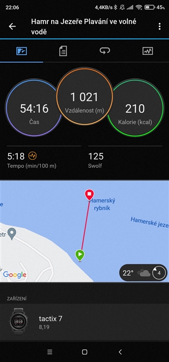

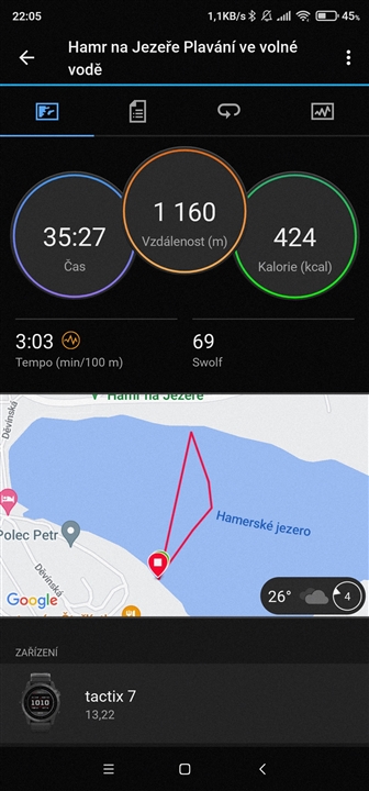

  • I tested this today again and if you get out of the water, the watch catches GPS and recalculate possible distance difference, you can see distance jumps in meters. And to me its as accurate as my previous 6X. If you look on screenshots from current and previous firmwares, you can see difference in a time, swolf, pace. The time of my swim is almost double! And from my experience I can say that on older firmware its frustrating to do such a swim. For me its fixed and I'm happy to see this improvement.
    • Since its fixed, I don't have any problem anymore. I only want to show difference between 8.19 and 13.22 firmware. GPS doesn't work underwater. Problem in older firmware 8.19 is some algorithm that estimate distance that I swim by movement or something. So I've to swim twice as long to actually get let say 1000m. Now on 13.22 firmware this distance estimation is accurate. On both of my activities I've got same pace in real world, its just 8.19 that only calculated this wrong.
    • Time is right on both I've actually have to do 54 minute swim, now it takes me 35 minutes to do same swim training, same distance. I've just want to say that for me and my watch I've consider this bug fixed and resolved and hope that other people feels same about this case.
    • If you look closer the two screenshots that I've post earlier are two different activities, first is 1 year old, and second is from yesterday, same watch but different firmware versions.
