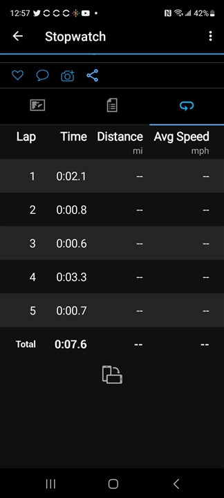

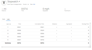

They get sync'd to Garmin Connect. You can see the results under Activities/Stopwatch. You can also review on your watch under History.

Hi Dan - I want to do something similar. I can see the activity on the watch under history like you said but not on Garmin connect. I don’t have a “Stopwatch” activity and I can’t even add one. If I go to “All activities” I can’t see it either. Did you have to install something ?
Are you on the website ? Does it also work for you on mobile ?
Yes
Thanks for your help Dan. I rebooted my watch and the stopwatch activities got synced to Garmin connect.
So I tried it a few times and it won’t sync until I reboot the watch. Very strange as all my other activity type sync immediately. Have you tried it with 11.28 ? Maybe it’s a problem with Garmin connect on IOS…
