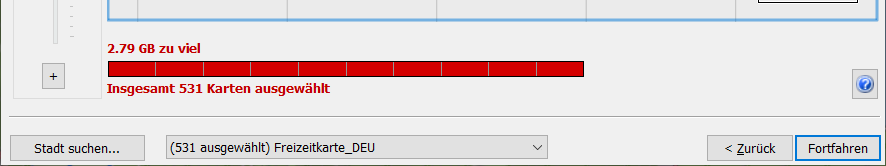

  2. When trying to install them to my Fenix, MapInstall directly brings a failure "6 KB too much".
    "6 KB too much"
    1. This while on the Fenix 14 GB space are free; no music, no other audio recordings, only plain training data stored on it.
    2. The map for Germany is 2.9 GB - so should fit perfectly well into the internal storage
    3. (and before anyone is guessing the PC also has more than enough space: C: has 230 GB left, D: 1,22 TB)
  3. When selecting all regions of Germany, it comes up with this ("2.79 GB too much"):
    2.79 GB too much
  4. Of course these data cannot be transferred, when MapInstall assumes that already 6KB are too much.
