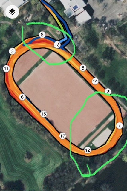

Hi
The Fenix 7 has every times in same areas problems with the GPS. I call it zig zag recording.
My Fenix 6s pro hasn’t the issue.
Both pictures are from the same run, today.
Hi
I found my issue.
the setting „lock on road“ was active.
How could that fix it? According to the manual:
"Lock on Road: Locks the position icon, which represents your position on the map, onto the nearest road."
that sounds like just a display setting on the watch. Also, you ran around a track so there wouldn't be a road to lock on to
It's also locking the gps track to the road.
Yes, the GPS following the road and I was wondering, why I ran on street only.
