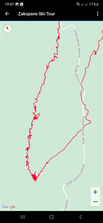

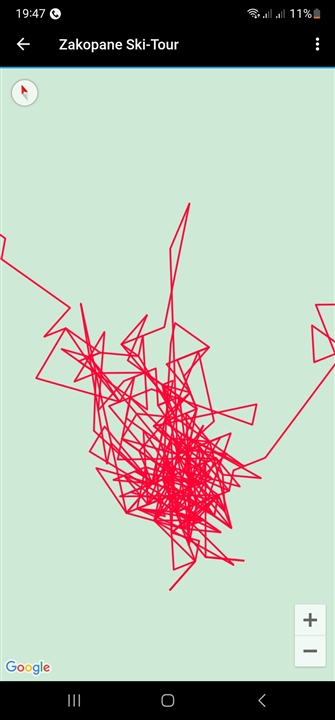

Why is the gps trace so inaccurate?
It's worse than the much cheaper Polar watch

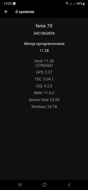

GPS tracking is messed for many outdoor sports since GPS 2.37 and above.
I've did many posts about it. The issue is also present in the FR955.
Just do a test. Go walk around your house. First use …

What I might be doing wrong
It's a trip to the mountains most of the way out in the open
in the watch all systems on record every second
software 10.46
Just do a test. Go walk around your house. First use "walk" app. Then do the same route using your usual ski app. You will see the difference. Post it here to pressure Garmin to fix this or just roll back to GPS 2.35 software.
