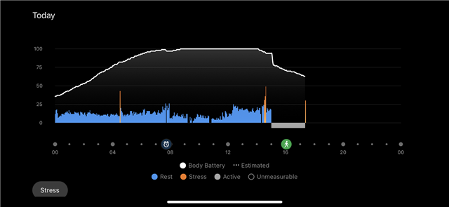

Does anyone know why I occasionally have a sudden drop in my body battery when I start a walk or run?
  • Yes, it's designed that way for a reason - it's because the watch does not collect HRV information during an activity recording, because it cannot accurately do so during exercise. After the activity is finished, the watch estimates the body battery drop that likely would have happened during the activity (probably using an algorithm factoring in time and exercise intensity), and applies that estimate to your body battery chart all at once at the timestamp where your activity began, resulting in what looks like a sudden sharp drop.
  • It is indeed weird to see a drop at the beginning of an activity. It doesn't seem to be happening to me
    Looking at your graph, it is also weird that the body battery didn't decrease in the morning at all (very weird flat line). So I assume the BB caught up when you started the activity (although something else interrupted the flat line just before you started the activity).
    One possible explanation is a window of time where the heart rate was not read properly. Maybe the watch was not snug enough or thought that you were sleeping (very low stress level).
  • Former Member
    0 Former Member over 2 years ago in reply to Etupes25
    I was lying in bed this morning so it stayed on 100%, but the sudden battery drop only occurs very seldomly so saying it’s designed that way isn’t correct and as you can see it declined steadily during the walk
  • I was lying in bed this morning so it stayed on 100%
    It wouldn't be a strict flat line. It could have been trying to update to a value higher than 100% and that created the flat line. So my best guess is that the BB was over estimated, and then it caught up first when you started moving, then when you started the activity.
    I have noticed that BB can be optimistic the day after a firmware upgrade. Could that be the case here?
  • Former Member
    Well I do get 8 hrs sleep a night and usually recover 65-70 points, so I was already at 100 when I woke and then did nothing all morning, heart rate at 50 and stress around 15, so I would expect it to stay steady
  • I was already at 100 when I woke
    I understand, but the stress data during your morning was less than during your night, which is unlikely if you were awake. Therefore, the watch mistakenly tried to increase your BB, but was limited by display/algorithm to 100%. Then, past noon, your stress level came back to worse than sleeping level, and the BB (which was above 100%) came down until 2pm where it started being below 100%. Then you started an activity, maybe the HR/stress readings were improved, and the BB was adjusted down.
    It still looks to me like there was a watch fit issue making the HR/stress readings wrong.
