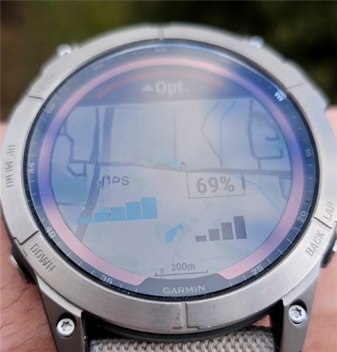

  • Just put Garmins and IQ gps bars on the map and checked. Both go full bars as soon as the arc is red.
    Zoomed in on the map, some dancing around at yellow then steady with green, a few seconds later it told me to press start and the position started dancing around again, switching between red and green.

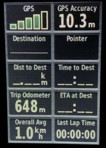

    Here as an example my 65s. It has both. Both a data field for signal strength and a data field for accuracy:
    A display of the signal strength alone says nothing.
    When I'm out and about with the handheld, I can often observe that a good signal strength doesn't always necessarily have good accuracy.

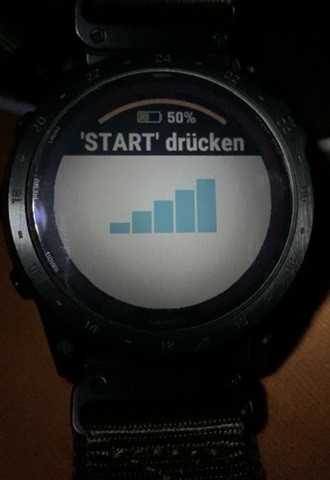

  • Former Member
    0 Former Member over 2 years ago in reply to bluefish
    These photos show the necessity of having an accuracy data field on the watch.  For those who didn't notice, the accuracy in the second photo became better even though the signal strength dropped.
  • These photos show the necessity of having an accuracy data field on the watch.  For those who didn't notice, the accuracy in the second photo became better even though the signal strength dropped.
    Exactly

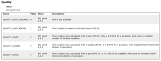

  • The graphical symbol indicates signal quality, not signal strength or accuracy.
    Signal quality is defined in CIQ as
    and CIQ uses Garmin's firmware via an interface.
    So the signal quality is composed of the number of tracked satellites and the HDOP.
    It may be that fewer satellites are tracked but the HDOP is better. For the calculation of accuracy a reference point (true point) is needed. So, for me it's not clear how "accuracy" is calculated at pics. Only the precision can be calculated. Accuracy and precision are often confused
