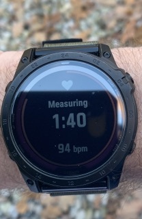

Cannot find how to do this. Can anyone help please?
The recovery HR is still measured automatically in the 2 minutes after having stopped the activity. It is just not being displayed automatically. However, you do not need to initialize the function to have…

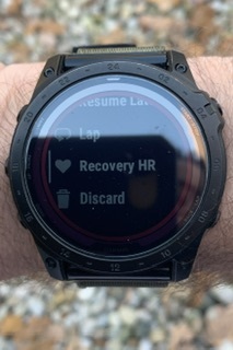

No. You have to use the option in the save workout screen.
Thanks wow talk about a downgrade of features....
It does display automatically if you wait for the required amount of time (2 minutes) before saving the activity. It'd be great if recovery HR were saved somewhere, though.
Hm, no. This automatic Recovery HR was removed a long time ago. Already when I was still on F6X. Now you have to use the option in the save workout screen. If you don't push it, it won't show any recovery HR.

It’s not actually removed IIRC. You have to scroll down to see it when in the save menu.
Correct
Not correct, it's about the automatic recovery heart rate, you are talking about a manual trigger.
The recovery HR is still measured automatically in the 2 minutes after having stopped the activity. It is just not being displayed automatically. However, you do not need to initialize the function to have the Recovery HR measured. If you hit the option later, the finished measurement will be there.
The Recovery HR value is also automatically being stored to the FIT file, and can be viewed with external tools or even with the DevTools of a browser (see an example below), when on the activity page. Unfortunately Garmin Connect does not display it, although it would be really useful, and trivial for Garmin to implement.
