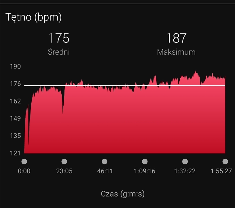

  • My 3 last runs. Fenix 7SS and Polar H10 (original battery replaced few weeks ago).
    Polar firmware 3.1.1
    Connection type Ant+
