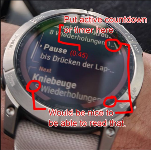

There is still this annoying problem since the redesign of strength training.
The German word for "repetitions" / "Wiederholungen" is too long and pushes the following weight value out of the screen. And yes that is useful information because we usually setup the weight for the next set during pause. It would be way smarter to use the official abbreviation "Wdh."
Here I have reps in a single digit, this barely allows the display of the first digit of the weight on the right border, in this case it would be lovely to be able to read that its 60kg (and not 65) to put on.
Then with double digit reps, the weight is completely off-screen, so that my first though was when this thing was introduced "the person who designed it must have never done weight training, because they forgot to list the weight", but turns out they did not forget, it just does not fit onscreen because of an unnecessary long word.
Additionally it is annoying to be forced back to the "list page", if its pre-plannend training, after every set is done and not remaining on the page I selected manually. Especially as the use of the "list page" at the moment is very limited, but could be improved by using the abbreviation for repetitions so it does actually show the weight of the upcoming set. And showing the countdown of the pause directly instead of having to scroll up every time.
Two easy adjustments to make it useful, active counter right in the middle (no scrolling needed), "Repetitions" = "Reps" giving enough space to show the weight and move it a little inwards at the bottom to be able to read the number of reps too.
Or just don't force us back to list view after each lap button press and stay on the page the user selected to use.

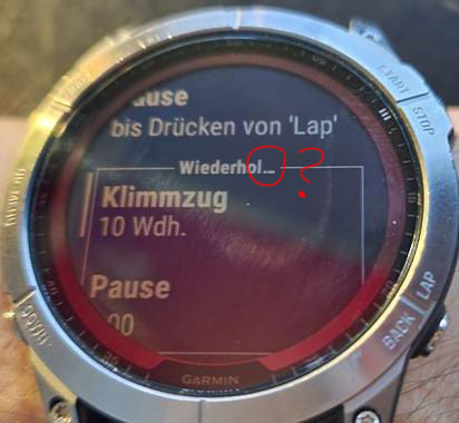

  • Here it's still an issue:
    That's the training overview before it started and should also show how often that block is set to be repeated.
    Same word, same issue, different location.
