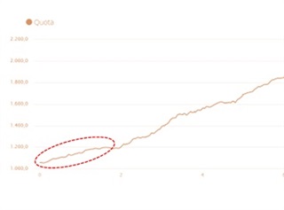

I bought Fenix 7 three days ago and made my first hike
I’m aware of some inaccuracy in altitude data, but this time I’m totally puzzled
I know for certain that the first couple of km, the trail I was doing climbs gently from 1000 to 1200 meters.
Instead, Fenix 7 data climbed steadily from 1000 to 1600
See here
As a result, I had for the whole trip both altitude and elevation overestimated by those 400 meters
In the reaming 10km recorded data seems to be 100% ok
Surprise came when I checked data back at home with connect
If I watch at the altitude graph it has that mysterious steady climb at the beginning

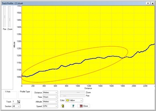

I then tried exported the gpx file from Connect and check altitude data using another software and … they are 100% correct! No such a mysterious initial climb…
Here is an altitude chart of that gpx with another software
Moreover: if I import back that same gpx into connect… it works fine and data/graphs are correct

I have Elevation correction disabled in Connect
On the Fenix 7 altimeter I have
- Autocalibration on
- Sensor Mode Auto
Conclusion: it seems like in that case Fenix 7 is reporting wrong elevation data (both live during the trip and in summaries/Connect) while it is recording/saving a gpx track with the right altitude data

  • Thank for your detailed answer
    I just want to point out that:
    • The starting 1.5km of my hike goes from 1000m to 1200 meters elevation. I know it from several previous experiences and from topographic maps
    • The elevation on Fenix was roughly correct at the starting point (around 1000 meters). Anyway, I’m interested in elevation gain rather than elevation itself. That’s why I always used barometer rather than DEM/GPS with previous Garmin devices. In his case however is used Auto
    • In this 1.5km the Fenix climbed from 1000 to 1600 meters (400+) with no spikes or outliers but very regularly (see firs chart). The chart is from Garmin Connect desktop and elevation correction is disabled
    • A gpx obtained using Connect using that same activity has very different elevation data for that first 1.5km (1000m to 1200m, +200meters, so perfectly correct)
    So, my understanding is
    • Having chosen Auto instead of barometric elevation, Fenix 7 used a mix of elevations.
    • Being that trail in a wood and close to rocks Fenix made a mix of pretty correct elevations, or at least pretty correct elevation gains taken via Barometer with incorrect elevation via DEM (due to cliff) and GPS (due to wood/trees)
    • That incorrect elevation/gain is used live on the watch as well as in Connect (I guess it is a .fit file)
    • When I exported a gpx from Connect it DOES NOT transform the .fit file into gpx. Instead, it saves a .gpx with Barometric data
    Sounds weird…What do you think?
    Nicola
