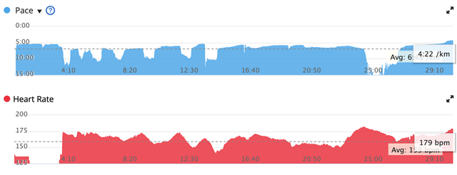

    24th Sept 2022 run with my first 7x on 9.33 connected to a HRM-RUN (now retired) -
    HR spikes from 137 to 153 @ 4:10 where it should have been higher sooner.

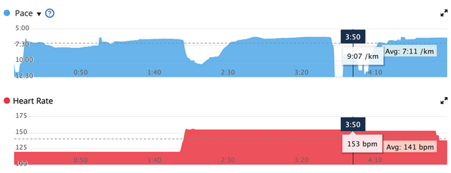

    Next is my new 7x on 11.28 connected to a Wahoo Tickr -
    And -
