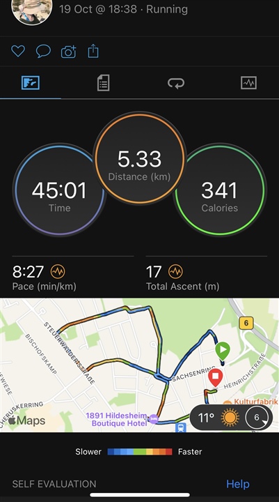

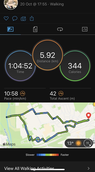

Two events. Both somewhat equal distance, both same elevation. Both nearly same calories! This can’t be right! METs for walking are much lower than for running. Why are calories for walking so bad?
Calories is a measure of energy and mostly depend on weight and distance, not on HR.
That is true for a simple mechanics, but not for the body. Calories burned by the body can be much better…
Calories depend on your heart rate and time, not directly on the distance or elevation. Also, since there is a 30% difference in time, the Resting Metabolic Rate (RMR) will have a big impact. You better…
Calories depend on your heart rate and time, not directly on the distance or elevation. Also, since there is a 30% difference in time, the Resting Metabolic Rate (RMR) will have a big impact. You better compare the Active Calories of both activities - they will match your expectations better.
Or add 20 minutes of the RMR to the first activity - only then they are comparable. You get the 20 minutes of RMR from your daily Resting Calories (RC) = 20 * RC / (24*60)
Calories is a measure of energy and mostly depend on weight and distance, not on HR. Yeah, Garmin also uses HR as an approximation, and it requires HR zones to be set correctly, but this is totally ridiculous. My zones are lab tested, and HR for walking is rather low compared to running. RMR calories, for a light-weight woman of a certain age are very low over 20 minutes. That makes close to no difference. The big difference between running and walking is that you use a lot more muscles in running and there's a phase where both feet are off the ground, hence you have to propel yourself into the air. Guess what: I just checked the net calories: they are nearly the same with a difference of 7 between running and walking. Thus something is clearly going wrong here. Heck, if I walk something like 20km at slow pace, just a relaxed stroll I get about 1500 net calories. That's totally ridiculous. For example this calculator (https://exrx.net/Calculators/WalkRunMETs), which uses METs gives me 600 net calories, and that is fairly realistic, not 1500.
