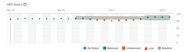

I don't know what's going on in your situation, but my HRV data have been very consistent since I installed 9.36:
The low overnight average reading of 66 on 30 SEP was caused by a large amount of alcohol before going to sleep - took a week for my HRV to get back to Balanced status.
