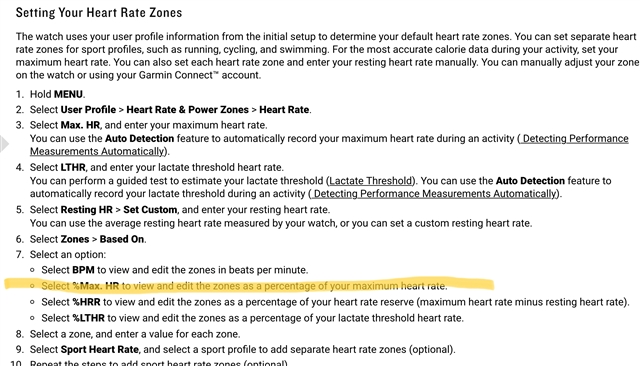

  • Thanks for that. The 935 was set HRmax 200 and Fenix 7X is 182 after 2 average runs. The 200 was probably real as I do have a high HR but I have had the 935 for about 5 years so my HRmax should have dropped by 5 in that time. Settings > Physiological Metrics > Auto Detect. was on but guess it was not smart enough to change that value over years and it is probably what is causing the disparity. The LTHR was the same for both at 175 which is about right for me.
    [edit] the fine print.
    NOTE: The device detects a maximum heart rate only when
    your heart rate is higher than the value set in your user profile.
