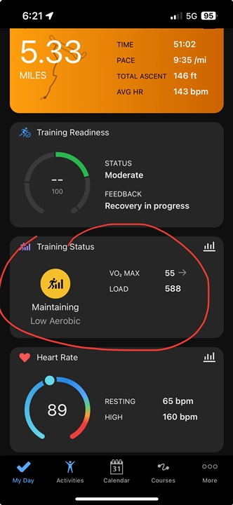

Mine finally showed maintaining today after 2.5 Weeks of running/walking. It’s like it was recording but not showing up. The app is now displaying it too. I think its based on your past average in the VO2 activity like running or cycling. Make sure Power is enabled in the activity too. I’ve been going slower than before working back up after surgery. I think now that there’s a consistent base that it will start tracking. Garmin says has to be one VO2 activity to show up. But that’s to keep it going. If you have taken off for a while and have not Pause Training activity I think it has to recalculate it again. Hope that helps. Also power cycle your watch as well.
