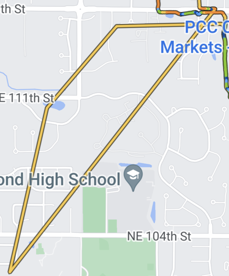

The last two runs I've have an issue with the GPS track jumping from the original course. Using all systems on fenix 7. Anyone else had a similar problem?

With the exception of the first and last it looks like you have “lock on Road” set (under Settings->Map) so it is jumping from paths and trails to the nearest road. Hard to tell on the first…
Does the "lock on road" option affect the recorded distance or it's only for better visualization of the track?
Your recorded distance is coming from your GPS track recorded.

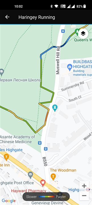

I had this a few days ago. I've never had this issue before either with 7X or 6X. This was in All Satellites mode. 8.37 firmware.
