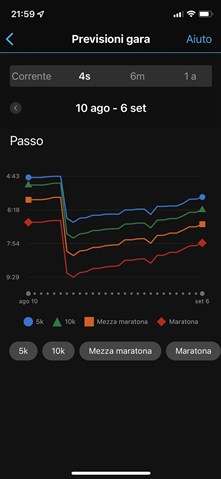

Garmin - Chris I have the same problem that hilighted Sandpappa .
This is the graphic where you can see the variations
I have been running faster than these predictions also in the last days.

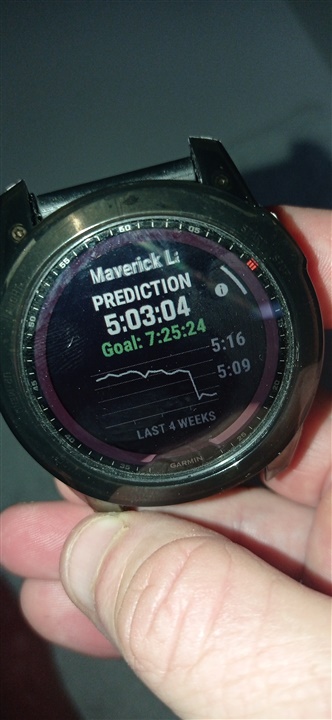

Garmin - Chris predicted race finish time is way off. I put in calendar an ultra almost 70km long with 1500m vertical meters, but my watch thinks I am able to finish this in less than 5 hours. And particulary with trail events in race calendar predicted times seems incorect.
I have a dip right at date / time too, not that big, but still.
So maybe it's something then.
