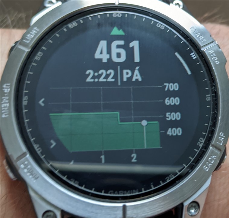

Last few days my activites elevation starts at 384m instead of right 450m for all activities and various gps settings. The auto calibration at night makes huge shifts from right 463m to 392m. The shift used to be about only 5m before.
The only help is to turn off auto calibration and then, when watch asks about new elevation while starting the activity, choose option to get right elevation from GPS. Then the watch gets the right elevation immediately.
But this was not necessary before, the elevation was always changed to right value at start of an activity. Even the manual says that:
If I didn't look at my recent activities, I wouldn't even noticed that problem. But I was surprised with strange bad elevation values at work and at home. The elevation is wrong all the day.

  • Hi Erik, thanks for the lot of informations. One hour ago, I returned from running. Little bit upset again :-). I got right 457m elevation before clicking start and select Running activity. But running activity started at 382m and ended also on same bad 382m instead of 457. But the elevation curve seems right but with offset. Maybe I'll turn auto calibration off for some time and enter elevation before activities. And hope that Garmin guys find some error elsewhere. There are new threads appearing with barometer problems...

  • Thanks again for the research! You did interesting work. I know the pressure spikes can show time to time, I'm ok with that. I have problem only with the beginning of activity, which shift the altitude from previous right value to something bad.
    Today 3,5 hours in car and I got right altitude in the finish within 10 meters. With no calibration since yesterday. Will see tomorrow's way backSlight smile.
  • I think the autostop(autopause to be correct) feature is causing problems since 9.33. When the feature is ON, every pause it "calibrate" altitude back to start position. On the sample the path to summit is the same for up and down, graph should be mirrored. On the summit I turned off the autopause function and the problem si gone.
  • ...and since autopause is off by default with my personal activities I'd never run into this ugly problem.
    Great job. I'm looking forward to Honzas experience with that.
  • Oh God, one will still didn't solve first problem and next problem appeared... I'll bet that there are more problems with altimeter in 9.33. In other topic, someone compare altitude with Edge computer and gets horrible results. I'm happy that I can't compare my watch with other Edge computerGrin. I have auto pause off, but will try that on next run.
  • Night on hotel. Shift from right 527m to wrong 462m. Seems like the watch thinks, that I'm at home, where 462m will be right. But I have everything disconnected at night.
