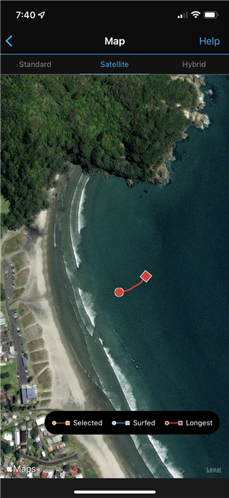

  • Interesting! It is definitely not military zones. It is nowhere near any military (I live out back in New Zealand). I have attached a picture of a windsurf where I usually do about 4 kms.

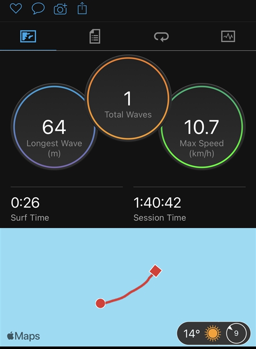

    weird. I have attached two pictures from a surf where I caught about ten waves, and only one got picked up.
    the gps literally just stops working when I go like 70 metres off shore  in the ocean
  • When you say “paddling” do you mean on a surfboard with your hands? GPS devices need direct line of sight to GPS satellites - if your watch is going  underwater every few seconds it can’t maintain contact with satellites.
    The “open water swim” setting is designed to try and combat this issue, and you might be able to change the activity type to something more suitable afterwards. The other thing tk try is just to keep your watch out of the water. Swimmers sometimes do this by clipping th watch to their head (e.g. goggles or cap).
