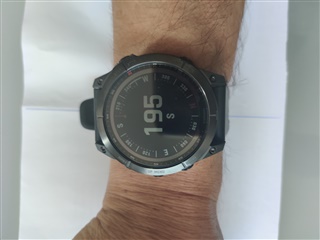

My Fenix 7 Sapphire Solar suffers from the frozen compass syndrome (see this thread), but it seems to also suffer from large inaccuracies even when it's not frozen. I'm wondering if anyone else is having these issues before I consider asking to replace my unit.
For every one of these tests I restarted the watch and completed a successful compass calibration:
  1. Point in one direction aligned with my desk (see image) and note the heading. Move away, wiggle my hand a bit, move it around and place it in the same position again. Here are is a series of readings from repeating this process: 119°, 124°, 129°, 131°, 126°, 119°, 113°, 89°, 113°, 118°...
  2. Compare this position with the opposite one (back and forth), again using the desk for alignment: 121° -> 292° [+171°] ->126° [-166°] -> 277° [+151°] -> 125° [-152°] -> 280° [+155°] -> 125° [-155°] ->287° [+162°] -> 122° [-165°] -> 296° [+174°]...
  3. Used a 90° creased paper for alignment and took photos of 4 perpendicular positions moving 90° each clock-wise each time (see images): 307° -> 030° [+83°] -> 105° [+75°] -> 195° [+90°] ( -> 307° [+112°])
  4. Tried to do the same thing with the watch off my wrist and laid flat on the paper, but as soon as I take it off, the watch goes into freeze mode again: 115° -> 153° [+38°] -> 108° [-45°] -> 075° [-33°]...
Is anyone seeing similar behavior?
