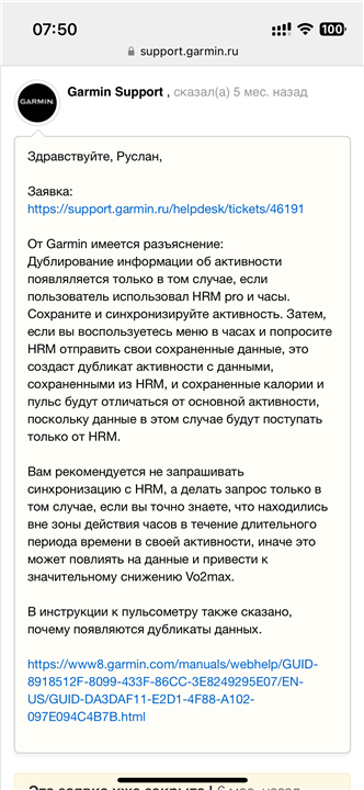

  • Greetings to all! I had the same problem! I reported this problem to representatives of GARMIN Russia last year! They sent me a reply from GARMIN, which says that when using the watch and the chest strap of the heart rate monitor, you need to save the first readings, and not those that we forcibly load from the chest heart rate monitor! I attach photos of their letters to those who are interested)! Good luck to everyone)
  • There is an explanation from Garmin:
    Duplication of activity information appears only if the user has used the HRM pro and the watch. Save and synchronize the activity. Then, if you use the menu in the watch and ask HRM to send your saved data, this will create a duplicate activity with the data saved from HRM, and the saved calories and heart rate will be different from the main activity, since the data in this case will come only from HRM.
    It is recommended that you do not request synchronization with HRM, but only make a request if you know for sure that you have been out of range of the watch for a long period of time in your activity, otherwise this may affect the data and lead to a significant decrease in Vo2max.
    The instructions for the heart rate monitor also tell you why duplicate data appears.
    www8.garmin.com/.../GUID-DA3DAF11-E2D1-4F88-A102-097E094C4B7B.html
