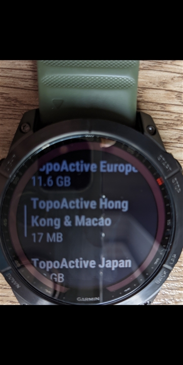

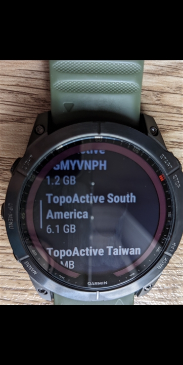

You are not offered a TopoActive map if it is already installed on your watch.
On your watch, please do the following:
- Quick press your top right button
- Highlight Map
- Long hold your middle left button, select Map Settings
- Select Map
- Select Configure Maps
Please take a picture of your watch to show what maps show on your watch and attach the picture to this thread.
Thank you. If you bought your watch in the United States or Canada, your watch will come with the TopoActive North America map on it since you own the Fenix 7X sapphire version of the watch. The sapphire versions already have the map for the country the watch was bought in.
