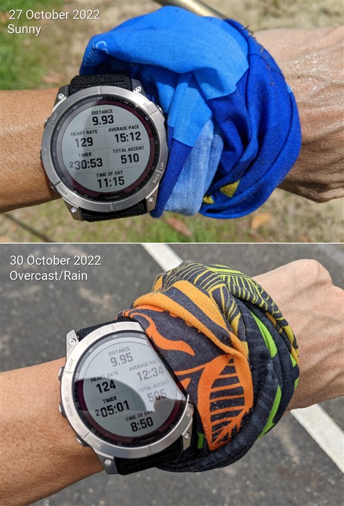

For those of you whose Fenix shows accurate Elevation Gain/Total Ascent numbers when worn on the right wrist or anywhere else but the left wrist, I made an experiment using a washer made out of hard foam to raise the watch by approximately 1mm while isolating the optical HR module so its operation isn't affected. Short hike on a very hot and humid morning ensured lots of sweat that would otherwise interfere with the sensor opening resulting in erratic readings.
Another friend with a dysfunctional F7s because she wears on her left hand and presumably a heavy sweater, watch recording excessive Elev Gains and problem stopped when she wore on the right hand. I'm doing this because while wearing on the right fixes the problem, we shouldn't have to and we don't want to. Today's experiments was successful against the reference Fenix 3HR but I would be more convinced when I have a chance to do the same on a much longer trail run activity.
Note: This post is not for the vast majority of people who have had satisfactory experience with their Fenix series but for those not insignificant number of individuals who have been frustrated by the occurrence (so many posts in the forums and I've seen them all). I'm hoping this is the beginning of hope. It's also not about the optical Heart Rate operation but the reasonable accuracy of the barometric altimeter function mainly Elevation Gains / Total Ascent numbers.
  • Last weekend, I travelled overseas for a 30km trail race. I was both excited (for the race) and nervous (Fenix 7x tracking accuracy). During training I had mixed results with accuracy of Total Ascent—some days good some days way off. It was only the last two weeks prior to race day I wore fingerless gloves on multiple occasions for comfort when running with poles. I then discovered Total Ascent numbers during those times were consistently accurate. Dorsal side of my left hand is always sweating profusely and that's likely the source of the issue.
    Came race day, I did the same and was incredible delighted that both distance and Total Ascent were very close to the official figures. If all it takes is a glove on the left hand, I'm all good. Not comfortable wearing the watch on the right or sticking a foam spacer each time I'm out for a long trail run.

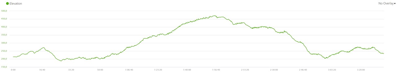

    When I look at the elevation chart in Garmin Connect it seems OK for about 20-25 minute into the run and then the chart gets jagged and this is where all the extra elevation gain happens.

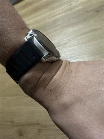

    This is definitely caused by sweat getting into the barometer hole. Perhaps you sweat excessively in that area. Try wearing your watch bracelet less tight. I don't have that issue at all. Well, it happened once to me in the last 3+ years. I haven't heard from anyone of my friends complaining about this issue either.
