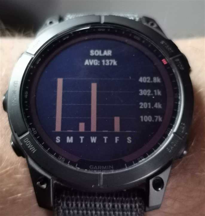

  • And are you still averaging 400k Lux/hr per day? I finished charging mine 4 hours after you and am down 31% with just one 47min activity (SatIQ GPS + music + Stryd). During this time period I had only about 90k Lux/hr.
  • Mine is also draining in about 10 to 12 days even while getting lots of sunshine, used to be 20!!
  • No, nothing close to 400k lux, the weather has not been sunny.

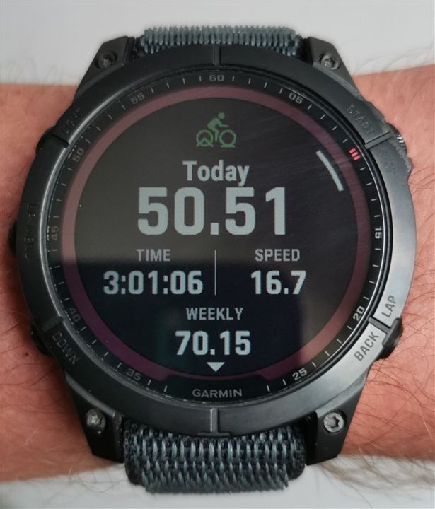

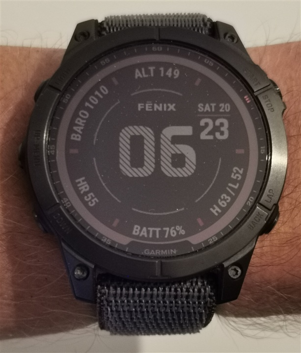

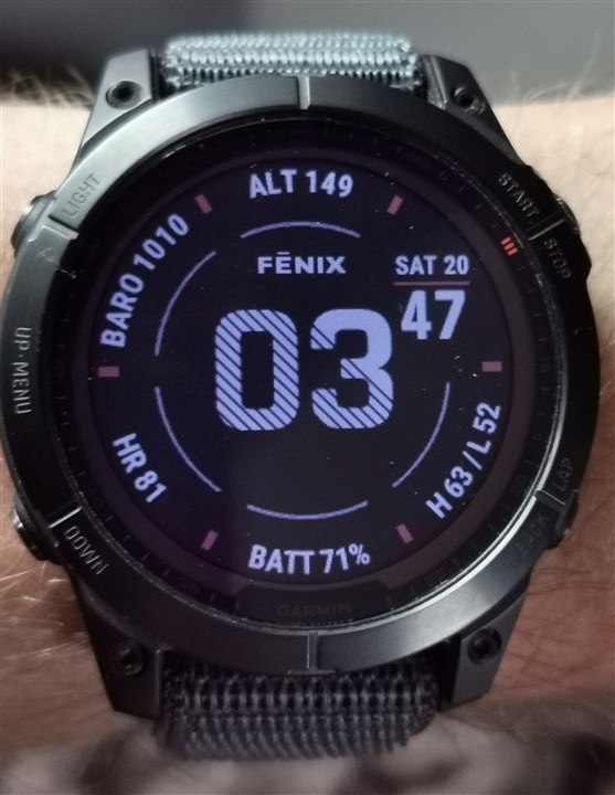

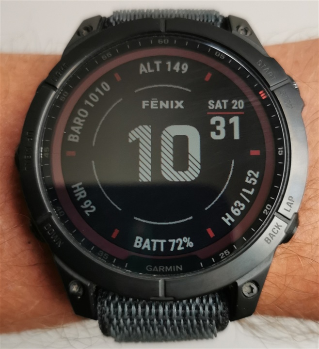

    This is my battery usage today
    At the start of the day 76% (about 4 days ago I charged to 100%)
    After 3 hours indoor today ride, I used 4%

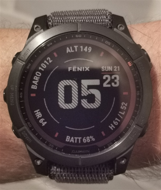

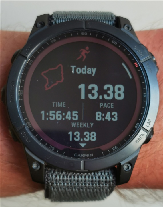

  • Now down to 63% 5 days fter charging to 100%
    About 2 hours of GPS on my long Sunday run used 5% (was 68% on wake up)
    No lux benefit as I started my run before 6AM.
    gps seems to use a bit less than I'd expect?
