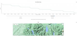

    What GPS mode do you use? Normal? All systems? All systems + multi-band?
    And still I do not know how to get to this stats page. I have FW version 9.31b and I don't have this one under widgets.
  • I use AutoGPS selection (SatIQ)
    Maybe the beta no longer has the widget? For the Fenix 6 firmware alpha and beta both have Device Usage widget but maybe this is different on the Fenix 7?
    I do not see a good reason to move from 9.14 personally so I will not be able to answer your missing widget question.
  • Then that makes it really hard to tell what's your GPS consumption based on this table. You said that 2 hours of GPS take you about 8% (did you notice that in the hours after an activity there seem to be higher consumption?)
    I also checked when I had 9.14b and I didn't see the widget there either... Strange.
  • I also checked when I had 9.14b and I didn't see the widget there either... Strange.
    Too be honest, if you are not finding it in 9.14 either then you are doing something wrong,
    You need to Add the widget with the + option, it is not there by default. You would not 'see' the widget it you did not know it existed or know that is has been a standard feature of beta firmware for the last 3 years or longer.
    This is the battery usage from yesterday's hike - I can only report what the watchface % reports before and after the activity.
    But double checking my figures, they are correct - start of day was 15% then end of hike was 7% - this was autoGPS (satIQ).

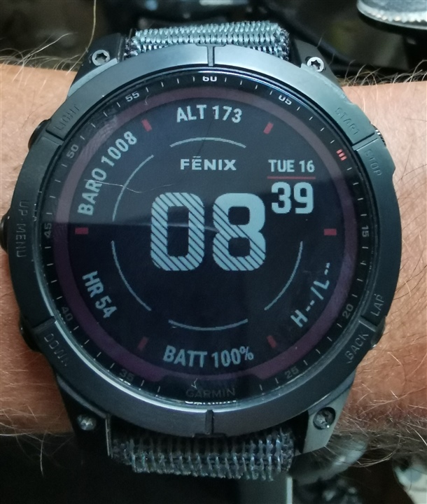

    100% on recharge Tuesday AM
    23 hours later
    And somehow still 95% after 2 hours GPS...!! Good solar effect again I think?
    I am surprised I am still on 95% after 32 hours too be honest.
  • So in the worst case scenario your watch lost 5,4% (100% -> 94,6%) in 23 hours which equates to 17,75 days per charge. I'm supposing this was without solar help?

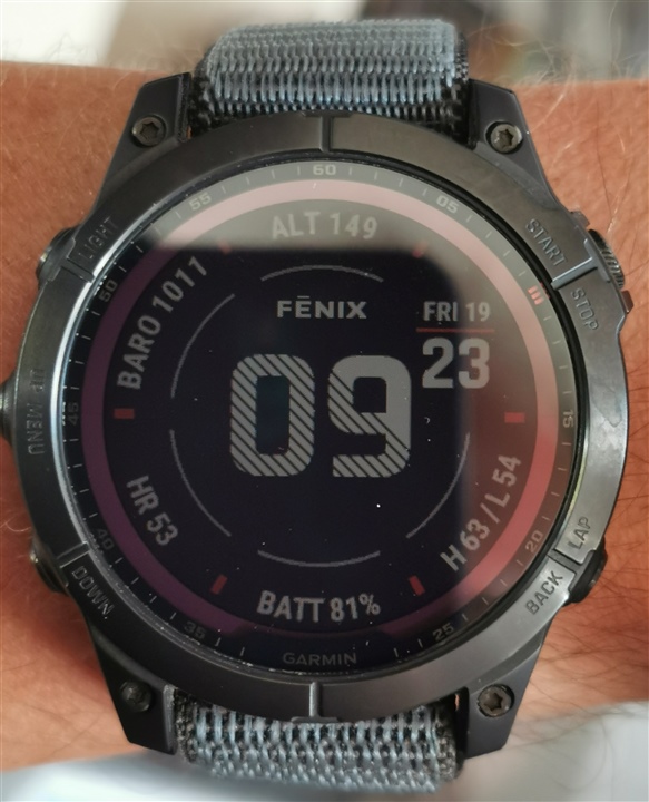

  • It is a bit more usage this time around.
    Yesterday 3 days after recharging to 100% on Tuesday this was my battery
    I did a 30 minute run and 40 minute walk with GPS on 18th August - this was early in the day so no solar benefit.
    I think this time I will get 12 to 13 days maximum.
  • That's 19% drained in almost 73 hours including over 1hr GPS. Since my last charge I've had a 20% drain in 68 hours without any activity (and hardly any solar charge)
  • Actually that is about 3 hours of GPS so far as I did a 2 hour bike ride on Wednesday (which seemed to use very little power somehow)
    Right now just under 4 days after charging to 100% I am now at 76%.
