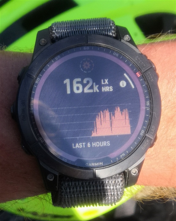

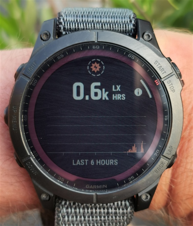

    At 8am today I left the house for a bike ride.
    At 930am I stopped for a break
    About 75k lux at that point

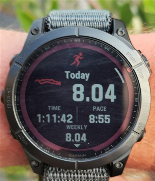

    At the end of the ride (just over 2 1/2 hours)
    So before 11AM I already have achieved over 150k that Garmin suggests to see a benefit. 23% battery remaining now. I will get to 17 days, maybe 18 if I do not use much more GPS.
    So to me, my battery performance is no mystery as I am benefitting from Solar as you can see.

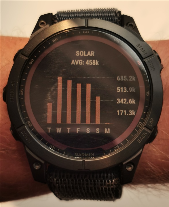

  • Early run before 6am so barely any solar benefit today. Now at about 15 1/2 days on this charge cycle - the 7 day lux average is about 375k lux

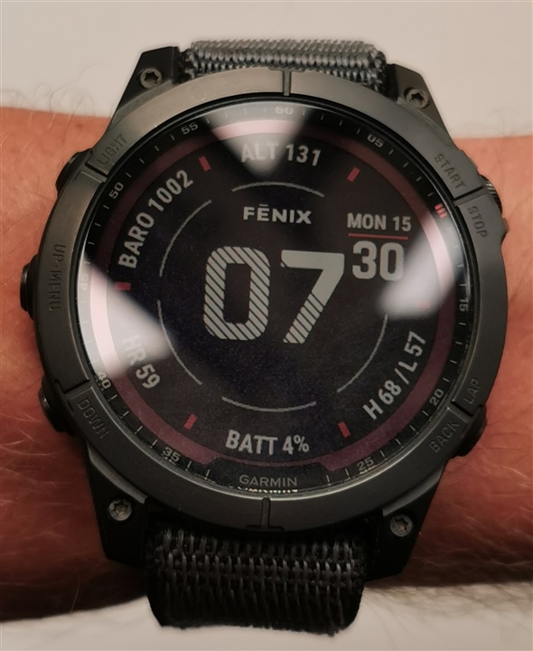

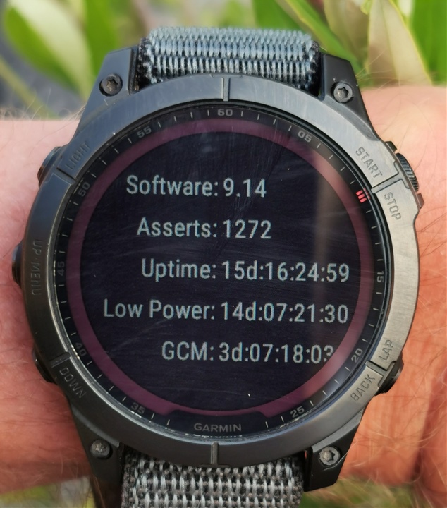

  • So after just under 18 days I am down to 4% and the Battery Saver yes/no prompt kicked in.

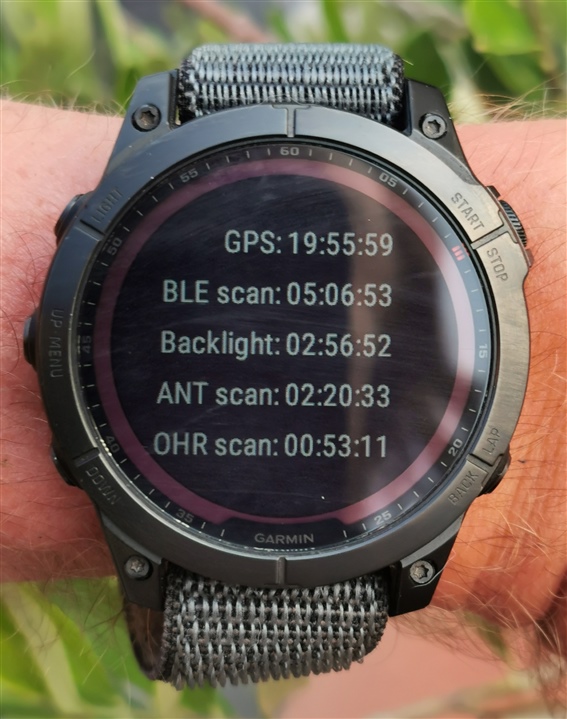

    About 24 hours of GPS used in total imcluding about 4 hours yesterday on a mountain hike + bike ride (good solar benefit yesterday)

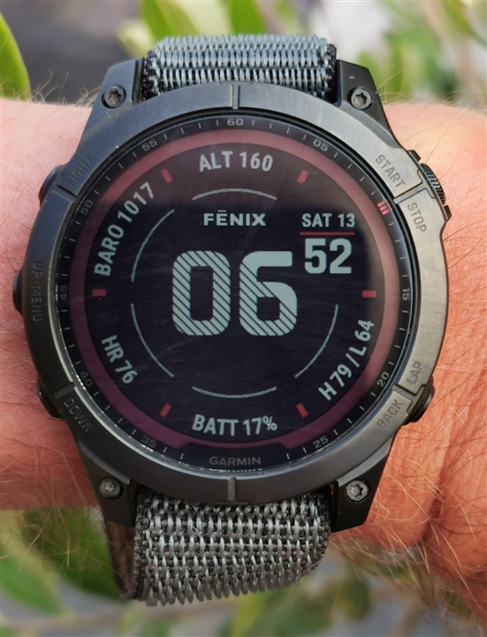

    Yesterdays GPS use (went from 15% to 7%)
    Last 7 days solar average
