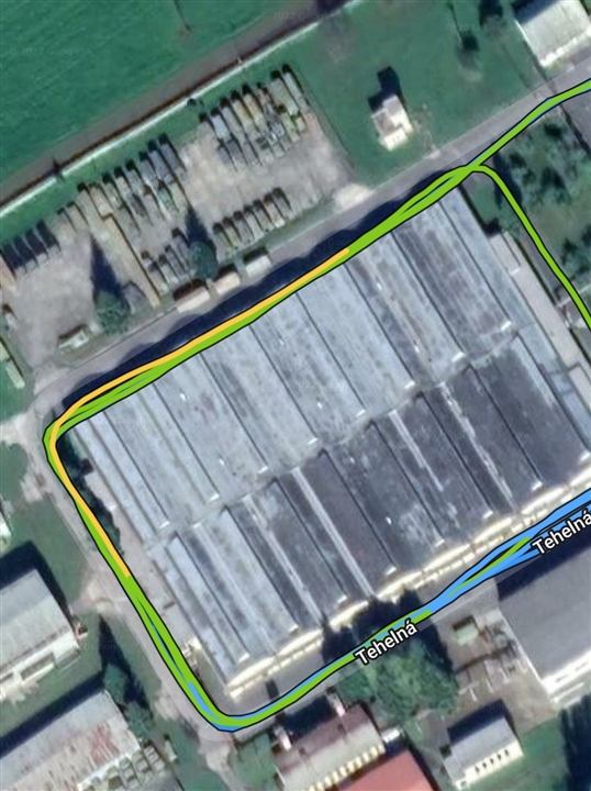

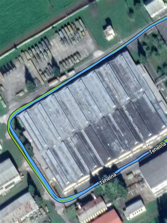

  • I made two runs (similary) on two ongoing days. Up is fenix 7x Sapphire solar, down is Fenix 6pro. I focus on few corners from Connect, made your own decision.
  • Yes, they are. But F6Pro seems better which I can't understand, because I'm happy that I sold that GPS crap and now I have very good experience with F7. But still my spare Forerunner 15 can fight with F7 in GPS accuracy! No step forward with F7 vs. FR15. I was amazed how good the FR15 is, when I sold F6Pro and waited for F7.
